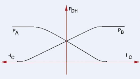

Port pressure gain is the slope of the dead head pressure curve vs control current at a specific operating point as applied to each of a valve's two work ports.Pressure metering curves are assessed with work ports dead headed. In servo-valves, the pressur
Figure 1 — Deadhead pressure metering curves are used to determine the pressure gain at each work port of a valve. Click on image for larger view.
Port pressure gain is the slope of the dead head pressure curve vs control current at a specific operating point as applied to each of a valve's two work ports.Pressure metering curves are assessed with work ports dead headed. In servo-valves, the pressure metering region is confined to approximately the center 5% of spool travel. For overlapped valves, pressure metering takes place over the entire dead zone, and more.
Referring to Figure 1, pressure gain is calculated as:
GP,A = dPDH / dIC
where GP,A is pressure gain,
PDH is dead head pressure at the particular valve work port, and
IC is the control current.
Optimally, two pressure measuring instruments can be replaced by a single differential pressure sensor or gage. It is the differential pressure gain that is reported in technical catalogs and literature:
GPD = d(PDH,APDH,B) / dIC
where GPD is differential pressure gain,
PDH,A is dead head pressure at the valve's A work port, and
PDH,B is dead head pressure at the valve's B work port, and IC is the control current.
For a servovalve with essentially zero overlap:
GPD = 2 GP,A = 2GP,B.
The pressure gain statement in a servovalve catalog reads as follows:
Pressure gain — The blocked cylinder port pressure changes rapidly from one limit to the other as input current causes the spool to pass through the null region. The pressure gain at null for servovalves exceeds 30% of supply pressure for commands of 1% of rated current, and normally is between 60% and 80%.
The first sentence is simply a comment comment and can be safely ignored. The second contains information needed for a pressure gain calculation.
A review of current valve technical data sheets reveals a variety of ways that pressure gain is stated. Even within a single manufacturer, there can be several different ways to express it. This only adds to the confusion on the part of those who want to use these valves and who could benefit from them. And ISO 10770-1 is silent on this matter, and its developers have missed an excellent opportunity to help standardize not only the procedures, but also the methods of reporting these parameters.
The valve manufacturer must provide a range on the pressure gain, because gain will vary from one valve to another. The reason is very practical: Pressure gain is a function of the amount of overlap, spool-to-bore clearance, metering land corner sharpness, and other results of manufacturing variations, all of which are well within tolerances. When you consider that the land-to-land dimensions and the spool-to-bore clearances are measured in millionths of an inch, it is easy to see how pressure gain can vary so much. In fact, pressure can be an important quality-control check for manufacturers.
Because pressure gain is so sensitive to very minute differences in internal dimensions, it can vary substantially from specimen-to-specimen. The wise designer will always try minimum, maximum and mid-range pressure gains at design time, because pressure gain does affect the application performance.
