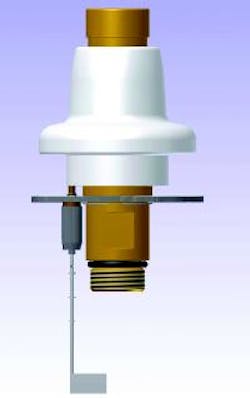

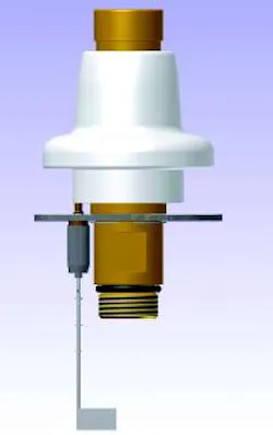

In order to pull the system together, Sunrise called on Parker Hannifin's Quick Coupling Div. to develop a non-interchangeable quick disconnect coupling that could handle oxygen service up to 2000 psi, and connect and disconnect under pressures from 1800 to 2200 psi. The 2200 psi specification was presented by Sunrise as an extra safety measure. The pressure transducer that initiates the automatic shut off feature allows a certain percentage of air in its tolerance. Sunrise wanted to ensure safe operation even if the calibration was off, so they specified the coupling to operate at a higher pressure than necessary.
The specifications could not be met by any products in the current product offering, so the engineers at Parker started working on a custom solution.
Figure 1. Quick-acting couplings created for Sunrise Medical can be disconnected under pressures from 1800 to 2200 psi.
Six months later, Parker delivered a custom, cone-shaped bottle nipple that allows the patient to easily connect and disconnect mobile cylinders for refilling, Figure 1. The couplings were designed to allow the mobile cylinders to be connected with just one hand. The coupler also has an integrated electrical switch to control the delivery of oxygen from the unit to ensure safe operation. An orifice on the coupling valve automatically releases pressure upon disconnection.
The main body components of both the coupler and nipple are brass. The internal components are comprised of brass and stainless-steel and use Parker's elastomeric seals and PTFE rings. The coupler sleeve and the extension tube are manufactured by Parker from engineered acetal. All materials were selected to ensure leak-free oxygen service.
"The new coupler was designed with safety and ease of use in mind," commented Parker project engineer Shawn Ellis. "Since the system will be used at home, we wanted to make sure patients could easily connect and disconnect the mobile cylinders."
