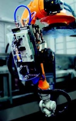

Directly installed on the robot arm, the power supply unit with the CPX/MPA is light and small, linking the pneumatic and electrical control levels.
Kuka, however, has a new way of getting around these issues. Integrated into Kuka's function packages on the third robotic axis is the latest Festo valve terminal technology of type CPX/MPA with vacuum — a very economical application. Plastic injection molding machines can now be lightly and easily equipped and unloaded.

The CPX/MPA valve terminal is practically custom-made for installation on the mobile A3 axis robot arm. It is particularly flat and can be housed in very small spaces. In spite of its low construction volume, the terminal offers high performance. Mechanically significant parts and manifold blocks are made from metal, making the modular valves thoroughly sturdy and reliable.
Economical vacuum
The media/power supply enables flexible connection of pneumatic and electrical control chains to form an individualised automation application. Flexible expansion stages (up to a total of four user valves and four vacuum circuits) are possible. Savings in power consumption and in maintenance are achieved by means of vacuum generators with air economy circuits.
