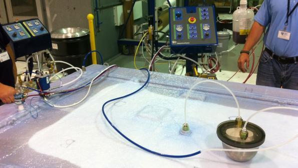

Flammability concerns have composites manufacturers opting for air logic over electrical controls.
Over the last couple of decades, regulations have gotten a lot tougher regarding worker exposure to hazardous materials such as styrene, as well as emissions of noxious fumes into the environment, says Austad. Safety concerns have grown, too. The resins are flammable, so minimizing fire hazards and, in turn, insurance costs, are also taking center stage.
That has spurred a move to closed-mold processes. As the name implies, instead of spraying material to make a part, the resin and other constituents are injected into a closed and sealed mold. Versions of this process include resin-transfer molding (RTM), light RTM (vacuum-assisted), vacuum-infusion molding, and closed-cavity bag molding.
Closed molding lowers emissions, says Austad. It results in a much cleaner work environment and reduces the need for protective clothing, respirators, and expensive ventilation systems.
The automated process also reduces manual labor and improves part quality dramatically, he explains. “Open-molded parts might vary by 15 to 20%, depending on the skill of the operator, and that can generate considerable waste. Closed molding takes that out of the equation by injecting the same amount of resin into the mold every time, resulting in minimal trim waste and less finishing after the part is made,” says Austad.

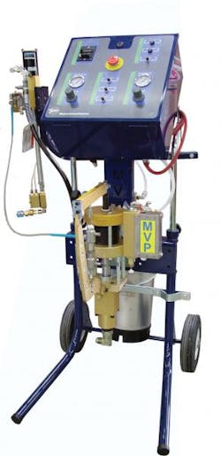

The Innovator II controls meter/mix dispensing for closed-molding applications.
Closed molding better controls component thickness and produces a higher-quality part that’s smooth and shiny on both sides, he adds. In open molding, on the other hand, one side of the part usually has a rough, unfinished surface.
But closed molding requires precisely controlled metering and mixing of the resin and catalyst, as well as the amount of catalyzed resin injected into the mold. Although it’s possible to use PLC-based controls with flow meters, because the resins are flammable that would require explosion-proof electrical systems which are quite expensive. Instead, MVP’s engineers opted for all-pneumatic controls using valves and air logic components from Cincinnati-based Clippard Instrument Laboratory.
Pneumatic controls
The Innovator II control box is an air logic panel with no electronics. It is used primarily with MVP’s Patriot mix/meter dispensing system, its newest generation of resin dispense systems. The Innovator II is specifically designed for closed-molding applications, including RTM, light RTM, and infusion molding, explains Tim DeLuca, vice president of MVPs RTM Division. The Innovator II is assembled and fully tested prior to shipment by Clippard distributor AOP Technologies, Auburn, Wash.
This meter-mix system delivers precise quantities of resin and catalyst to the mixing head, automatically blends them, and then injects the mixture into the mold.  The pneumatic controls perform three major tasks, explains DeLuca. The first is to repetitively inject the same shot size into the same cavity every time, eliminating guesswork on the part of the operator. Once user-designated injection parameters have been reached, a counter circuit shuts off injection at a predetermined pulse count.
The control’s second function is to manage injection input pressure and prevent overpressure conditions which could blow out clamps or resin seals, says DeLuca. A pneumatic switch – called a PV switch – can be mounted in the mold for closed-loop control. “The PV switch is a self-contained feedback device that senses resin pressure in the cavity,” says DeLuca. “When the switch trips, it removes the run signal from the control box and closes the mix heads and stops the pumps. Once the pressure is reduced, the switch turns back on and resumes the injection cycle.”
“Customers who require higher precision, say for aircraft or automobile parts held to tight tolerances, are more likely to want this option,” notes Austad. Overpressure can damage the mold or result in parts with inconsistent thickness. So sensing pressure lets the controller slow down the pump or shut off the injector, or both.
The last, and perhaps most important, function is the control interlock system. At no time can the operator accidently push the wrong button and botch the process. During certain cycles of the machine, other functions are locked out and not usable. This prevents costly mistakes, says DeLuca.
