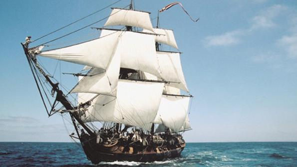

The 60-ton prop is a full-size replica of the H.M.S. Surprise, a 179-ft sailing ship boasting a towering 130-ft main mast. From the outside, and the right vantage point, it looks just like a seaworthy sailing vessel. But inside, it's obvious that this is nothing more than a sophisticated stage prop.

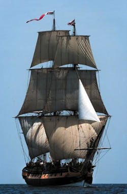

The HMS Rose, shown here, is a sea-going sailing vessel that was replicated and placed on a motion platform for action sequences.

The replicated HMS Surprise is virtually indistinguishable from the Rose as it rests in a huge tank.
Before it was transformed into the H.M.S. Surprise for the film, the tall ship had been christened the H.M.S. Rose, and served as a floating museum in Bridgeport, Conn. Film makers purchased the Rose and converted it into the fictional H.M.S. Surprise. This seaworthy set is used in shots taking place out on the open seas. Because its movements can be precisely choreographed and controlled, the Surprise replica is used for closeups and scenes that must be carefully choreographed.
