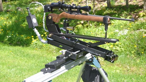

Jeff Malloy is shown with a bench-mounted version of his Equalizer Adaptive Shooting System. It can also be mounted to a wheelchair for greater mobility.
LLC faced many challenges designing its revolutionary adaptive shooting system for moderate and severely disabled persons. One such challenge was coming up with a reliable, sensitive, and easy-to-use trigger actuation system. With those factors in mind, Jeff created a simple air pressure system with technical assistance from engineers at World Magnetics Co., Traverse City, Mich.
Now, with a simple puff into a straw, an operator is able to activate the trigger mechanism to reliably shoot a firearm. The DesignFlex PSF103 pressure switch, from World Magnetics, was chosen for this application because of the need for a durable, compact sensor that would switch a 12-V supply. Available in a wide selection of pressure ranges and port configurations, this  pressure switch was adapted to meet the Equalizer Adaptive Shooting System’s exact needs.
Individuals with different levels of disabilities can wheel up to the Adaptive Shooting Bench, aim a firearm using an 8 way ultra-sensitive joystick, and fire the weapon with a single puff of air. The air puff actuates the PSF103 switch, which energizes a trigger actuation circuit. The system can be bench mounted or custom mounted to a wheelchair.
