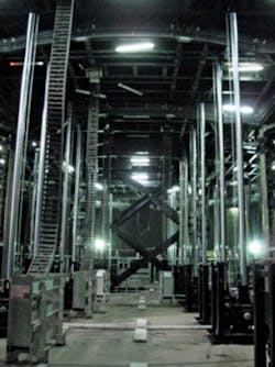

1. The stage used in The House of Dancing Water production is composed of 12 sections that can be raised and lowered independently for a wide range of effects.

2. Here is a view of the hydraulic cylinders in the empty pool under the stage. The LMDT rods are visible next to the cylinder rods.
