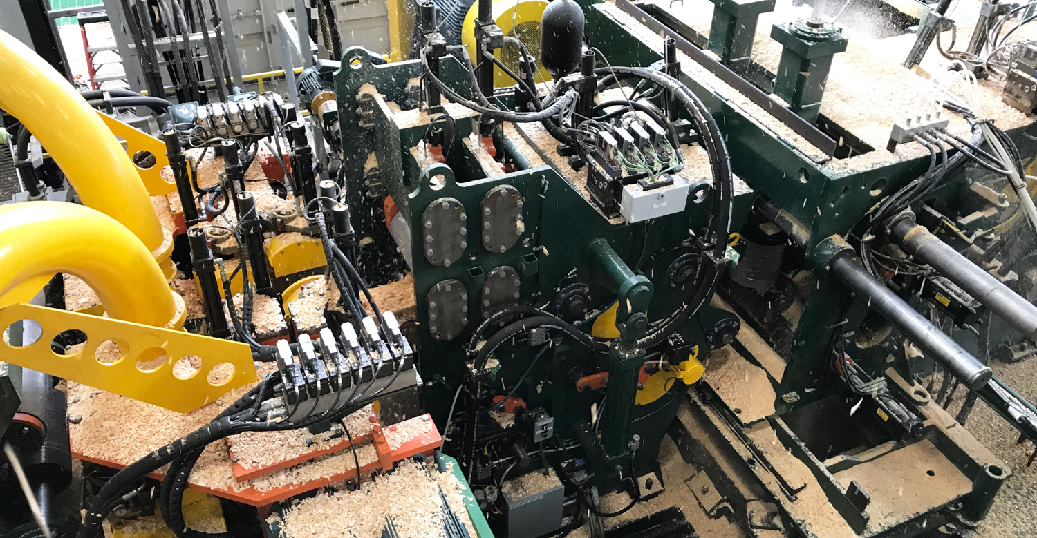

Fig. 1

Today’s sawmills are hotbeds of motion control. Modern integrated saw lines rely on coordinating the motion of dozens of moving parts to maximize productivity. For example, AMS Solutions, of Enderby, B.C., Canada, designs customized automation solutions for sawmills across North America. Experts at AMS recently completed the design and installation of a new canter profiler gang saw (Fig. 1), in a dimensional-lumber mill in the Northwestern U.S. The system AMS installed incorporates 26 hydraulic motion axes being managed by a Delta Computer Systems RMC200 motion controller.

Canter-profilers aren’t simple machines. The system designed and installed by AMS was a double profiler, which could profile two boards off each side of a cant simultaneously, enabling the gang saw to cut the different-sized boards from the cant in a single pass. Managing the canter-profiler heads, however, requires controlling a total of 26 motion axes: 11 axes to move the profiling cutting tools on each of the left and right sides, plus four axes for the gang saw (two to control guide rolls that align the cant into the saw and two more to slew/skew the saws to follow the curve of the cant). The motion-control solution for this application needed to be able to control and synchronize the motion of such a large number of axes to get optimal results from the sawmill’s profiler investment.
