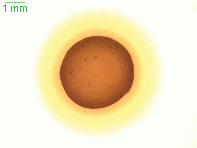

Figure 1. A drop of oxidized hydraulic fluid on a filter paper shows how oxidation debris is highly polar and tends to agglomerate. (All photos courtesy of Milwaukee School of Engineering.)

To illustrate, if you pour some cooking oil into a glass, it’ll take days, even weeks before it darkens in color, which is a sign of oxidation, Figure 1. But pour the same amount of cooking oil into a frying pan — which gives the oil a large contact area with air — then heat it up, and the oil will become black in a very short time.
