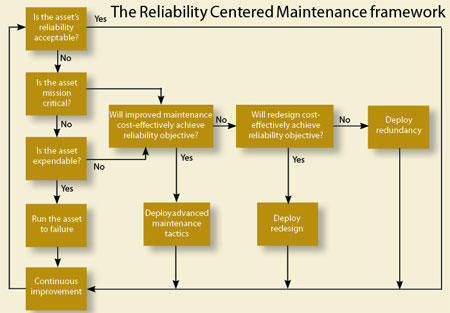

Figure 1. The Reliability Centered Maintenance framework helps ensure that the cost of proactive maintenance does not exceed the cost of the consequences of failure.

One of the most common tools used for helping determine what is and is not a dollar well spent is the Reliability Centered Maintenance (RCM) framework, Figure 1. Placing PM within the RCM framework ensures that the cost of PM tasks do not exceed the cost of the consequences of failure.

And not all machines will warrant the time and effort involved in doing RCM properly. If a machine can break down without posing a safety risk (although this is not always obvious) or incurring a high economic cost with respect to lost production and downtime, then it’s safe to say it’s not critical to the plant (see Figure 1). Therefore, it is not a prime candidate for the deployment of advanced, proactive and predictive maintenance tasks.
