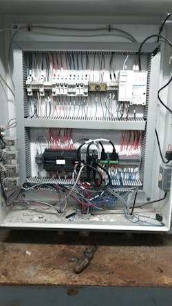

FCPS was approached by quarry personnel to help repair the automation system of a jaw crusher when its controls and associated equipment experienced control system issues that caused operations to halt.
Initially, the quarry operator hardwired a series of relays and switches allowing limited operations to resume in a manual mode while the troubleshooting process was underway. The jaw crusher and associated devices were originally built using a Modicon programmable logic control (PLC)-based system for control and monitoring, but the quarry did not have in-house personnel to support this legacy system. In fact, they did not even have access to the PLC program, which is not uncommon when dealing with original equipment manufacturers (OEMs).
Therefore, running the crusher manually was a stopgap option that severely limited operational throughput. An initial attempt was made for external support to replace the PLC, but this was found to be cost-prohibitive, so manual operation continued. As activity increased at the quarry — requiring the jaw crusher to ramp up production to multiple days per week — the operators knew a better solution was needed.
This is when the quarry approached FCPS to aid in the repair of the jaw crusher’s automation system. As an electrical contractor specializing in industrial design, installation, and repair services, FCPS quickly got to work assessing the client’s needs.
The FCPS and quarry teams quickly determined the best solution would be retrofitting new automation starting from scratch.

Although FCPS typically uses another major automation brand, the team decided that to meet the budget and delivery constraints for the jaw crusher project they would be better served by using AutomationDirect PLC and human-machine interface (HMI) products (Figure 2).
The selected PLC was a BRX stackable micro brick form factor that does not require a base or backplane. This compact size made it ideal for retrofit within the existing control panel footprint. The BRX line is incredibly versatile, with the functionality, processing power, input/output (I/O) interface, and communication protocols necessary for a modern automated industrial control system.
Additional I/O expansion modules easily snap onto the side of the BRX controller, which was useful for the jaw crusher application. HMI duties would be carried out by two C-more CM5 series color touchscreen units.
Initially, FCPS had some reservations about learning a new platform on a tight deadline, but ultimately, they found it to be an enjoyable challenge. Although there was a lot to learn, there was no shortage of support; the FCPS team was able to leverage tools from AutomationDirect and other industry PLC programming and HMI configuration experience to rapidly increase their comfort level with the BRX and C-more platforms.
The free software provided with both was intuitive and FCPS quickly developed the ladder logic and associated graphics objects.
Automation Technology Selection Eases Integration and Support
As the old controller was removed and the new PLC was installed, it was clear that the existing I/O field wiring was too short to reach. Rather than spend hours replacing it all, ZIPLink pre-wired connection cables and modules were utilized to minimize the need for intermediate connections or splices.
The ZIPLink wiring solution simplified the I/O termination process and reduced the opportunity for wiring errors by extending field connections away from the I/O modules with a connectorized cable and easily accessed field terminals.
