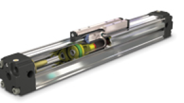

Rodless cylinders operate within their own length and can have high load and moment capacities.

Exceeding the capacity of an actuator’s internal cushions can damage cushion seals and sealing bands.
A cushion slows the cylinder’s load at the end-of-stroke to avoid impacts that damage the seals, bearings, bands, and head. Air cushions operate by trapping air at the end of the actuator stroke, when the cushion spear engages the cushion seal. Inertia of the load compresses the trapped air, and the cushion’s needle valve controls the rate at which it exhausts. The cushion needle should be adjusted when the actuator is installed (easily done with a screw driver). It cannot be properly preset at the factory because the amount of cushioning required depends on the application. Cushions should be adjusted so the load comes to a gradual and smooth stop at the end of stroke, with no “bouncing” motion. Periodic readjustments may be necessary during the life of an actuator.
In this installation, several factors led to failure. Although flow controls were used, no initial adjustments were made to the cylinder’s internal cushions at the time of installation. As a result, excessive pressure built up at the end-of-stroke because the cushion needle was not allowing air to exhaust. Pressure spikes resulted, damaging the seals and band. Once this occurs, the cushion becomes inoperable and air leaks from the sealing band.
Tolomatic technicians also discovered that the final load velocity in this application far exceeded the capacity of the actuator’s internal cushions. When load inertia is beyond the capability of the cushion, the resulting damage to the actuator is the same. Pressure increases at end-of-stroke and causes the same deformation to the band, breaking the seal and rendering the cushion inoperable.
