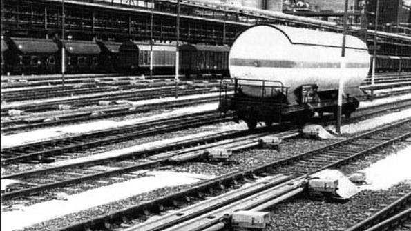

Pneumatic cylinders act in concert to squeeze rails onto freight car wheels in braking operations. The cylinders use Orkot Slydring rod and linkage bearings to tolerate constant exposure to weather extremes and contamination.
An important parameter in car humping is speed. The car must be going fast enough to actuate the coupler, but excessive speed creates unnecessary shock that can damage components and freight. To control speed of the rail car, a jaw-type rail brake slows down cars, when necessary, before they contact the train segment already assembled. To accomplish this, a series of 10 to 12 brake actuators — each powered by a pneumatic cylinder — pushes on a moveable rail that presses against the inner surface of the car’s wheel flange to slow down the car.
The brakes are used for reducing and  the speed of of rail cars.  This is no easy task, considering the mass of the car — each wheel set can carry a load of 25 tons or more. Moreover, the relatively small surface area of wheel flanges requires high braking forces to be generated.
Furthermore, as with most railroad equipment, components of the rail brakes are constantly exposed to the weather and must perform repeatedly in the frigid cold, blistering heat, during heavy downpours, and while subjected to sand, dirt, ice, and other contaminants.
