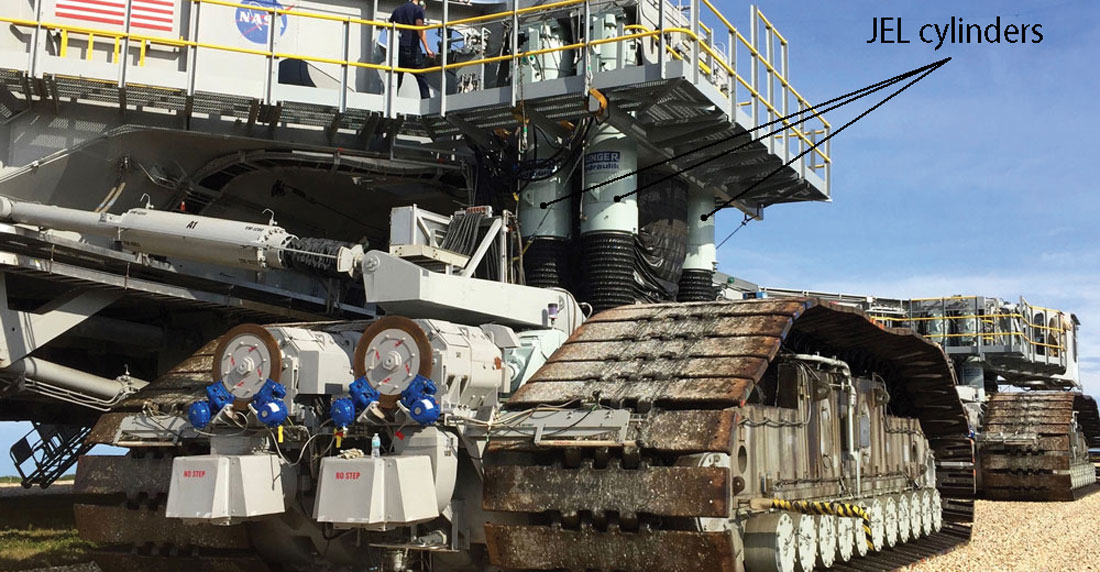

For loads as high as 6,000 tons, the hydraulic JEL system supplements the vehicles’ eight chain tracks, two in each undercarriage. These tracks measure 10 m long and 35 m wide.
The JEL system was designed with 16 single-acting hydraulic cylinders, four of them in each corner of the transporter’s undercarriage. With this system, the crawler transporter could lift the completely equipped launch platform from its parking slot in the vehicle assembly building, level it during the transport and for the launch pad ramp drive, and drop it on the launch pad slot. To realize these functions, the hydraulic cylinders have a stroke length of 2 m, which also provides a compensation angle of 5 deg for the launch pad ramps.
Spherical bearings mounted on rod end and bottom of each cylinder gave them the required freedom of motion during steering and leveling operations. Load control was done by remote controlled pressure-control valves on each cylinder. It was also possible to hydraulically shut off a single JEL cylinder and to maintain the load with the three remaining JEL cylinders for emergency operation. The central hydraulic power unit is installed in the center of the load frame structure and provides all sixteen JEL cylinders with pressurized hydraulic fluid.

Spherical bearings—To improve the longevity and reliability of the JEL cylinder bearings, the design was changed from steel ball bearings with steel clevis and pin to maintenance-free spherical ball joints. The old bearings sometimes cracked, but the new design is expected to be more robust and should withstand even overload conditions. The spherical ball joints offer a larger bearing area, which reduces the contact stress in the material. This design is also free of bending stresses in all loaded parts.
The bearing material is a maintenance-free Hunger H-Glide lining, combined with a hardened steel ball as a counterpart. It allows a free tilting of 7 deg in any direction, with a maximum compressive strength in the lining of 160 MPa. An inner retention pin keeps both bearing parts together. The bottom side spherical ball joints are equipped with an anti-rotation device to avoid uncontrolled rotation of the JEL cylinders.
