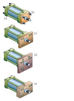

Straight line—Cylinders with fixed mounts that absorb the force on the centerline of the cylinder are considered the best for straight line force transfer. Tie rods extended, flange, or centerline lug mounts are symmetrical and allow the thrust or tension forces of the piston rod to be distributed uniformly about the cylinder centerline. Mounting bolts are subjected to simple tension or shear without compound forces; when properly installed, cylinder bearing side loading is minimized.
1. Fixed cylinder mounts that provide straight-line force transfer are: extended tie rod s(a or b) and tie rods extended at both ends (a and b); rectangular head flange (c); square head flange (d); and rectangular head (e), which provides same service as (c) but the entire head is rectangular, rather than an added flange.
Cylinder tie rods are designed to withstand maximum rated internal pressure, and can be extended at either end and used to mount the cylinder. When the tie rods extend at both ends of the cylinder, one end can be used for cylinder mounting and the opposite end can support the cylinder or be attached to the machine members.
Flange mounts also are extremely good for straight line force transfer applications. Three standard styles are head (rod)-end rectangular flange, head (rod)-end square flange, and a larger and thicker rectangular head with its own mounting holes; the same three versions are available for the cap end of the cylinder. Selection of a flange mount depends partly on whether the major forces applied to the load result in compression or tension on the piston rod.
