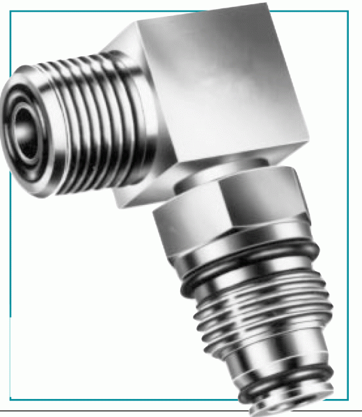

SAE's new J2337 fittings are the latest weapon in the war against leakage. But these fittings offer more than leak-free performance.
SAE’s new J2337 fitting relies on a strategic combination of mating metal surfaces and O-rings to provide leak-tight sealing, yet allows the mounting orientation to be adjusted.

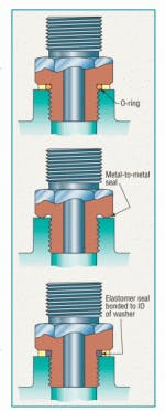

Fig. 3. O-ring with retaining ring, cutting edge face, and metal elastomer bonded seal suffer from the same basic limitations as O-ring boss port fittings.

O-Ring boss port fittings - Straight thread O-ring boss port fittings, Figure 2 (SAE 2244, ISO 6149, DIN 3852, JIS B 2351) were developed in the early 1950s and are a good solution for many hydraulic systems. However, considering today's higher system pressures, it is at its upper performance limit based on its design.
The pressure rating for a straight connector is 6000 psi for smaller sizes and 4000 psi for larger sizes. For adjustable fittings, the pressure rating is 6000 psi for smaller sizes and 3000 psi for larger sizes. SAE J2244 is rated to 9100 psi.

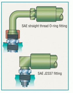

The swivel feature eliminates the need for an adapter and eliminates one potential leak point in a typical tube and/or hose connection to the component body. Figure 6 compares both installations with the same functional features.
This comparison can be extended to any other tube connection such as 24° cone compression, 37° flare, and many others. In addition to cost reduction and simplification, the swivel feature reduces installation time, reduces assembly problems, and simplifies plumbing systems.
