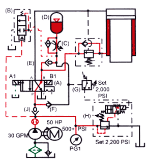

Pump supplementing circuit with full pressure when work is contacted
Fig-1-31
In some cases, a pump-supplementing accumulator circuit can speed up cylinder extension and/or retraction without having to go above working pressure. Normally in a pump-supplementing circuit, the relief valve is set as high as possible above the working pressure to store ample fluid. As the cycle progresses, oil from the accumulator and pump move the actuator quickly, but circuit pressure drops steadily. If pressure drops below the actuator’s need, the pump must refill the accumulator before the cycle finishes. To overcome this problem, a larger pump and/or more accumulators are necessary.
The next circuit shows an accumulator arrangement that provides high volume to move the cylinder rapidly with the relief valve set at working pressure. The accumulator and pump supply volume to fill the large bore cylinder as it extends. The cylinder then moves to working pressure while a check valve isolates the accumulator.
Fig-1-32
Like all accumulator circuits, there must be time for refilling between cycles, as shown in Figure 1-31. Pre-charge the accumulator to a pressure slightly higher than it takes to retract the cylinder. The cylinder will then retract when directional valve A and normally open, solenoid-operated relief valve H shift. (Also see Figure 1-34.) The large piston rod reduces the return volume, although retract pressure will be higher. When the cylinder fully retracts, pressure climbs and the accumulator starts to fill through check valve E and the bypass check valve around flow control C. Piston-type accumulators are best for this circuit because they can have a low pre-charge pressure and a high final pressure without internal damage. The accumulator can discharge a large volume of oil because the pressure in it is not important when the cylinder needs full tonnage.
Fig-1-33
When pressure in the circuit reaches 2000 psi, pressure switch G de-energizes the solenoid on normally open, solenoid-operated relief valve H, unloading the pump to tank.
When directional valve A and normally open, solenoid-operated relief valve H shift, Figure 1-32, pump flow and accumulator flow provide a large volume of oil to quickly stroke the cylinder to the work. Because accumulators can discharge at a very high rate, use flow control C to set the desired advance speed. Pressure in the circuit will fall as the cylinder extends and will be well below working pressure before the cylinder meets the work.
Fig-1-34
When the cylinder contacts the work, Figure 1-33, check valve F keeps pump flow from going to the accumulator. The pump will continue filling the cylinder and pressure will build to whatever it takes to do the work. Check valve F blocks flow to the accumulator to isolate it during the high-pressure work stroke.
When directional valve A shifts to the retract position, Figure 1-34, pump flow goes to the cylinder rod end. The accumulator pre-charge is high enough to force all pump flow to the cylinder, causing it to quickly retract.
Figure 1-31 shows the cylinder reaching the top of the stroke. The accumulator now accepts all pump flow through check valve E until pressure switch G unloads the pump.

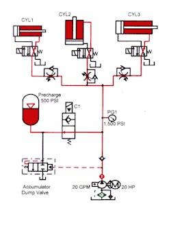

The circuit in Figure 1-35 uses a pressure-compensated pump and a normally open, poppet-type, 2-way directional valve. All flow goes directly to the accumulator, filling it to maximum pressure with the pump operating. When the cylinders start to cycle, flow from the pump and accumulator move them rapidly. When the cylinders contact the work, pressure is well below the required amount. To get full force, energize solenoid C1. This stops pump flow to the accumulator and raises the cylinders to full pressure. De-energize solenoid C1 when the cylinders finish their work to allow the accumulator to refill.
Energizing solenoid C1 when the actuators are moving is possible with a correctly designed poppet valve. Notice the blocked position of the valve has a check valve symbol, meaning it only stops flow to the accumulator. This type of poppet valve provides accumulator volume to the actuators when pressure is low. However, maximum pressure is immediately available when the cylinders meet resistance. De-energize solenoid C1 at the end of the cycle to refill the accumulator. Some poppet-type directional valves have a very high pressure drop when flowing through the closed check valve. Use a brand designed for low pressure drop in this circuit.
Fig-1-36
The circuit in Figure 1-36 has a fixed-volume pump with a normally open,, solenoid-operated relief valve and pressure switch to unload the pump at maximum pressure. Minimum system pressure for this circuit is 1500 psi. Therefore, it is important to set the sequence valve in front of the accumulator to this pressure. Set the pressure switch to unload the pump at 1700 psi. Then set the normally open, solenoid-operated relief valve at approximately 1900 psi. Because no oil can go to the accumulator if the system pressure is below 1500 psi, the actuators will always have maximum force anytime they meet resistance. When the cylinders are moving to and from the work, pump and accumulator flow can combine to give rapid movement at reduced pressure. Flow from the accumulator can always go to the cylinders through the bypass check valve. Fluid only goes to the accumulator when pump flow is greater than the system requires. This circuit fills the accumulator anytime the cylinders stop or anytime required volume is less than pump output.
There will be some heating of the oil while the accumulator is filling until system pressure reaches 1500 psi or above. One advantage is that no control circuitry is necessary, even while the accumulator fills anytime actuator volume is less than pump flow.

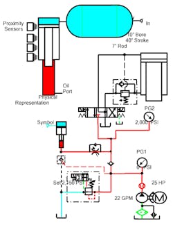

Non-invasive way to check accumulator pre-charge
It is important to check accumulator pre-charge pressure at regular intervals. Check a new installation each shift for a few days to see if there is a gas-pressure loss. It the gas charge is holding, check pre-charge pressure weekly for the next month. If all is well at the end of a month, then monthly checks should be more than satisfactory.
The normal way to check pre-charge pressure is: (1). Shut down the system. (2). Attach a gauge and charging kit to the accumulator. (3). Open the gas valve and check the pressure reading.
However, this procedure is time consuming, allows some gas to discharge, and may damage the charging valve, which can result in a continuous leak. Outlined below is a simple, non-invasive way to check accumulator pre-charge pressure to see if gas is leaking.
Fig-1-37
Figure 1-37 shows a partial accumulator circuit. This figure shows an operating hydraulic system, just as the pump stops. At this point, the accumulator relief/unload/dump valve is open, draining pressurized oil stored in the accumulator. As fluid in the accumulator discharges, pressure at gauge PG1 starts dropping. By controlling the flow with a fixed orifice or a flow control, pressure deteriorates slowly when there is oil in the accumulator.
Fig-1-38
When all fluid is out of the accumulator, Figure 1-38, pressure at gauge PG1 will suddenly drop to zero. Carefully note gauge pressure when it suddenly drops. The pressure seen at the sudden drop is the present pre-charge pressure of the accumulator. This reading is only as accurate as the gauge and the person reading it. It is not a perfect reading, but will be close enough to see if a full-fledged check is needed.

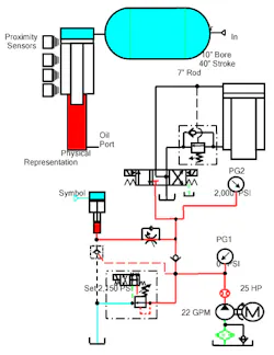

Fig-1-39
If there is more than one accumulator on the machine, as in Figures 1-39 and 1-40, this test will show the lowest pre-charge pressure. When a low pre-charge pressure shows up, check each accumulator individually until finding those at a lower pressure than required.
Another way to check pre-charge pressure is to note the gauge’s pressure reading when turning on the pump. With an accumulator in the circuit, the first pressure reading should be pre-charge pressure. It is difficult to obtain an accurate reading this way with glycerin-filled or orifice-dampened gauges in the circuit. The gauge should also be at or close to the accumulator to keep line losses from adding to the reading.

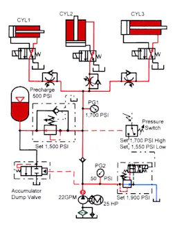

If the circuit
uses a fixed-volume pump as shown in Figures 1-41 through 1-44, use an accumulator relief/unload/dump valve for most applications. This valve has an integral adjustable 2-way unloading valve A to unload the pump when reaching set pressure. Also, there is a pilot valve to close shut-off B that stays closed while the pump is running and opens any time the pump stops. Isolation check valve (C) keeps accumulator oil from back flowing to the pump when it stops.
Fig-1-41
In Figure 1-41 the pump has just started, so pressure jumps to accumulator pre-charge pressure and all flow goes to the accumulator through check valve C. Pilot-operated 2-way shut-off B pilots closed when the pump is running. The pilot-operated, adjustable-spring shut-off Astays closed until set pressure is reached.
Pressure continues to climb until the accumulator is full, as seen in Figure 1-42. When pressure reaches that set on 2-way adjustable-spring valve A, it opens, unloading the pump to tank at low pressure. Even while unloading there is enough pressure to keep pilot-operated 2-way shut-off B closed.
Fig-1-42
When pressure in the circuit drops approximately 15%, Figure 1-43, unload-valve A closes, again forcing oil to the circuit and accumulator. The pump will load and fill the system any time pressure drops about 15%. This pump load pressure is non-adjustable so it will not work for all circuits.
Some manufacturers offer an accumulator relief/unload/dump valve with an adjustable differential setting. Setting these valves’ load-unload pressure by more or less than the 15% differential is possible.
When the pump shuts off, as in Figure 1-44, pilot pressure to 2-way valve B drops, allowing it to open. Now all stored fluid from the accumulator has a path directly to tank. The accumulator will quickly discharge, making it safe to work on the circuit.

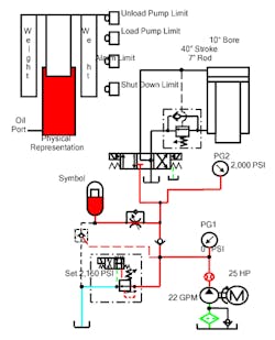

The circuit in Figure 1-49 shows a weight-loaded accumulator, a fixed-volume pump, and a normally open, solenoid-operated relief valve that can replace either circuit shown in Figures 1-10 and 1-11. Notice the maximum pressure and working pressure are at 2000 psi. This is possible because the weight-loaded accumulator does not lose pressure as fluid discharges. Until the accumulator piston reaches bottom, system pressure stays constant.
Fig-1-49
With a weight-loaded accumulator, the amount of weight on a given piston area sets maximum pressure. To raise or lower maximum pressure, weight must be added or taken off. Set the relief valve on this type circuit 100 to 150 psi higher than system pressure so it does not bypass during normal operation.
The main disadvantage of a weight-loaded accumulator is its physical size. An accumulator for the circuit shown in Figure 1-49 would require a 10-in. ram with a 60-in. stroke for the cylinder to have full force for its entire cycle. This size accumulator needs almost 160,000 lb of weight on the ram to get the required volume and pressure stated. A block of concrete approximately 1080 ft3 in size or about 10 X 10 X 11 ft would be necessary to meet this need. Such high mass eliminates the use of this type accumulator for mobile equipment and also rules out many industrial applications. Using a smaller accumulator ram with a longer stroke reduces weight, but you must make sure column strength is adequate when reducing ram diameter.
