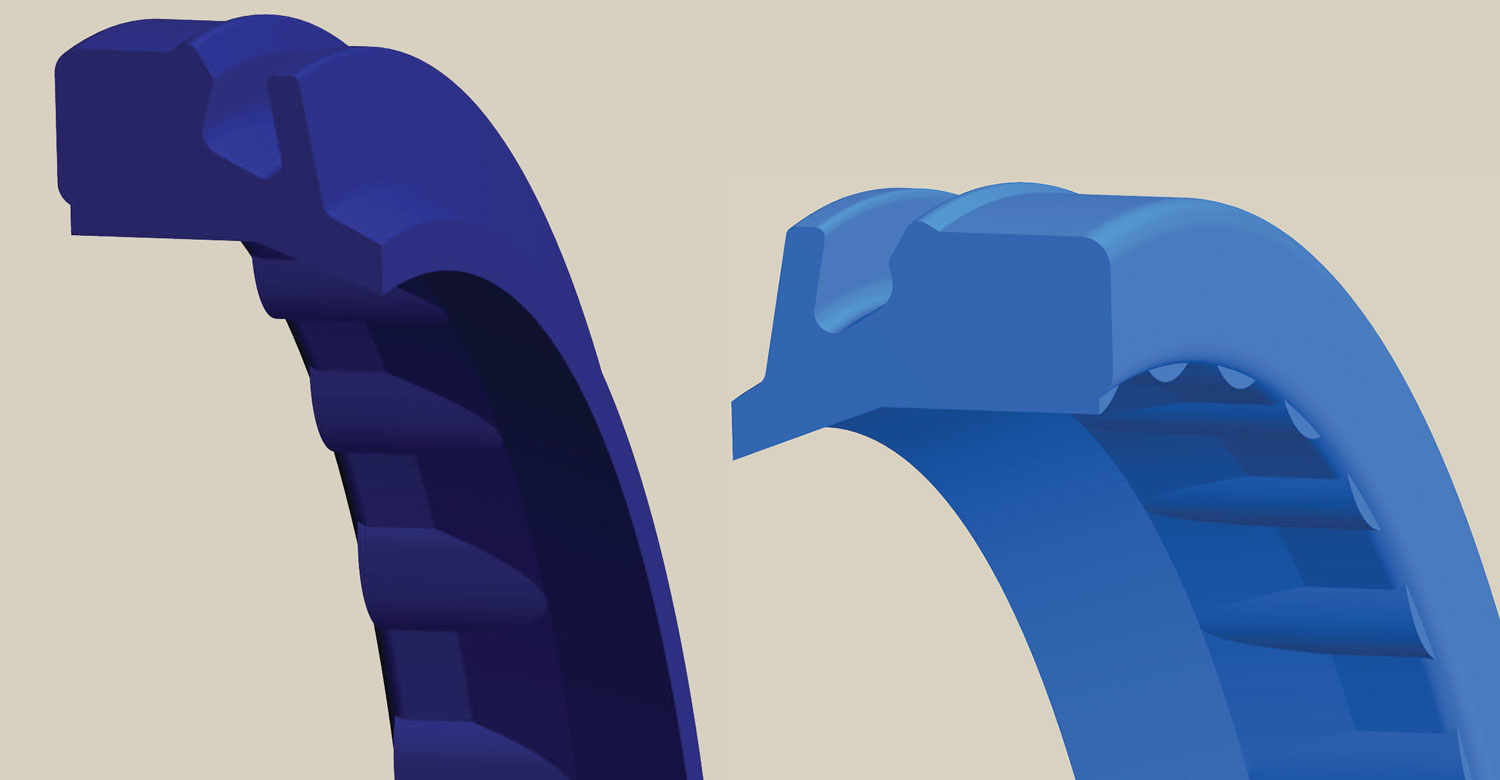

The 820 and 842 rod wipers

The 820 rod wiper (left) is available in several proprietary polyurethanes and is compatible with mineral oils and HFA (95/5) fluids used in longwall mining equipment. The 842 is a single-lipped, snap-in rod wiper developed specifically for use in environments with heavy contamination.
Wipers Provide Protection
Rod wipers are commonly used in dirty environments (especially mobile equipment) to prevent contaminants such as dirt and moisture from entering the hydraulic system as the piston rod retracts. Contamination can cause significant damage to the rod, cylinder wall, seals, and other components in the hydraulic system, and is a major cause of premature seal and component failure.
Hallite’s 820 rod wiper is available in several proprietary polyurethanes and is compatible with mineral oils and HFA (95/5) fluids used in longwall mining equipment. The 842 is a single-lipped, snap-in rod wiper developed specifically for use in environments with heavy contamination, such as agriculture, off-highway equipment, forestry, the aggregate industry, and longwall mining. Both the 820 and 842 wipers feature Umbrella Wiper Technology—a protective debris guard flap on the wiping lip that covers the gland housing and prevents the water and slurry trap often occurs with conventional wipers.
