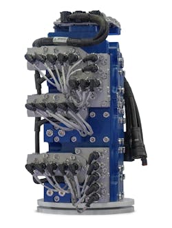

“Hydraulics are evolving into digitally controlled, intelligent systems,” said Khaw. To achieve this, the company is bringing hardware such as its PVG valves together with advanced control platforms to help create full system solutions.
Gonzalez and Holter noted similar design trends. For Husco, Holter said a solenoid — the digital to hydraulic interface — is added to its valves to create an electrohydraulic component which interacts with a controller to provide the desired operation.
Rather than having a mechanical link between the joystick in the operator cab and the valve, logic is built into the controller which provides an output signal for the valve, he explained. This enables more conditions-based control which can help improve overall performance. “When I just have one lever [joystick]…I can only do so much. It's cost effective, it works. But by adding automation now, you can start to add more knowledge of the system, add more understanding to be able to do what I call conditions-based control,” said Holter.
By better understanding machine condition, adjustments to the hydraulics can be made to match the particular operation being undertaken, such as digging, to ensure optimized and efficient performance.
This condition monitoring and control is a principle Festo is applying in its Controlled Pneumatics family of products, said Gonzalez. These pneumatics solutions combine proportional technology, sensors, and control algorithms into a closed-loop control system.
Sensors and controllers built into the closed-loop system perform all necessary performance calculations. Users simply need to enter their desired parameters, and the control system takes care of the rest. This allows for easy setup as well as flexibility to make changes as needed based on current performance conditions or other requirements.
