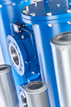

Eaton supports system designers with a broad and specialized range of filtration products that ensure a high degree of purity and reliable operation across all industries. Application-specific filter and accessory design plays a major role in the almost endless amount of media, process variables and ambient conditions: Eaton offers more than 4,000 different filter elements, each with matching filter housings. These filter elements are available with various filter materials, in different designs and filter ratings, to help protect important system components.
The return-line, suction and pressure filter elements and elements for in-line filters are used in single and duplex filters for low-, medium- and high-pressure applications and are considered the industry standard in many places. In addition, there are mobile and stationary filtration systems, systems for contamination and condition monitoring, and auxiliary devices such as contamination indicators.

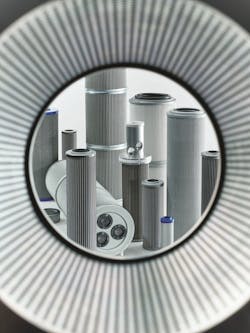

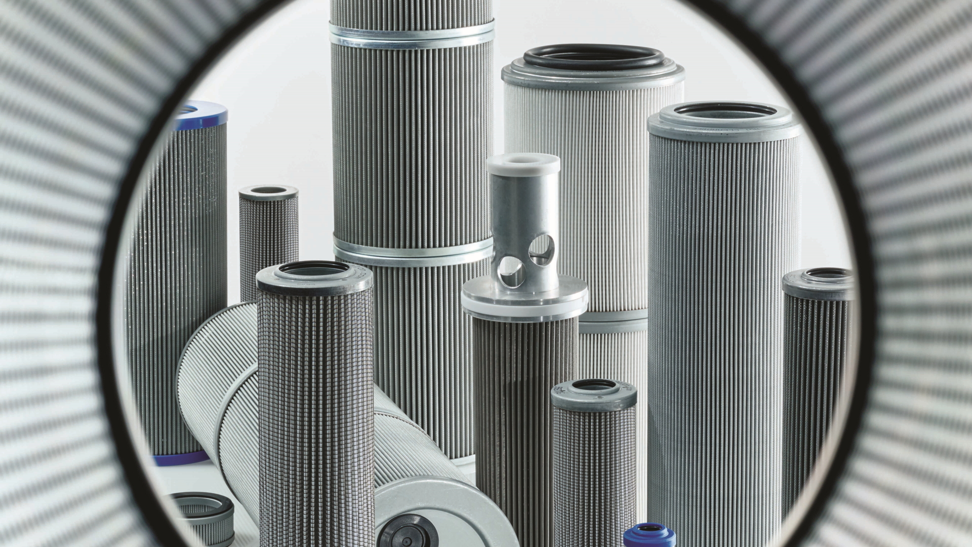

A filter element consists of a support tube, around which the pleated filter media is wrapped, and two end caps. The pleated filter media with various filter and support materials are the core of the filter element. Depending on the requirements and the hydraulic filter design, different filter materials, filter ratings and types are used for surface and depth filters.
Filter materials use glass fiber fleece (VG, API, WVG), polyester (V) and cellulose (P) nonwovens and papers, and stainless steel wire mesh (G). These materials are available in various filter micron ratings, the retention efficiency of which is designated by the beta value (ß): The larger the beta value, the more particles are retained by the filter and the higher the retention efficiency. The beta value is determined according to ISO 16889 and ranges from ß200 ≥ 4 µm(c) to 25 µm(c) for fiberglass media, which act as depth filters, and from 10 µm to 250 µm for wire mesh media, which act as surface filters.
To ensure reliable, trouble-free operation, all components such as O-rings and filter element load-bearing parts should be selected and, if necessary, adapted according to these specifications. Eaton can also customize filter elements from the existing range special applications. For example, gaskets and adhesives can be customized to withstand extremely low temperatures of up to 58° F (50° C).
