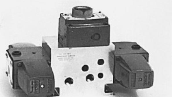

Figure 1. (Top view) Free standing drilled-block manifold accepts three different valves; (Bottom view) Drilled metal-block manifolds with 1- and 1¼-in. ports accommodate high flows.

Drilled metal-block design " Drilled metal block manifolds, Figure 1, also can be custom-designed for specific applications. Usually made from a slab of steel, aluminum, or cast iron, the blocks are drilled to provide flow passages for design requirements. This network of drilled passages also enables you to locate valves as desired, with some limitations because the drilled passages must be straight.
Other drilled-block manifolds accept cartridge valves into cavities drilled into the manifold surface. Interconnecting flow passages travel through the manifold from the valve cavities. Some cartridge valves have threaded bodies that hold them in threaded cavities; others slip into smooth cavities where they are retained by plates on the manifold surface.
