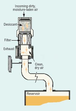

Desiccant-type filter breather removes solid contaminants and water vapor before they can enter the reservoir.
To resolve these contaminant ingression problems, contractor Barnes & Reinecke Inc., Elk Grove, Illinois, installed a special reservoir breather for the M109. The breather mounts inside the engine compartment near the reservoir to which it is connected through the fill port. The breather is constructed of Nylon and polycarbonate plastics that allow it to withstand rugged operating conditions.
When fluid level in the M109’s reservoir lowers, air enters the breather through a flapper valve which seals the unit from the atmosphere to prolong the life of a desiccant cartridge. The air next passes through a bed of silica gel which removes water vapor. The dried air then passes through a filter — with a Beta rating greater than 75 — which effectively removes the particles that could damage the system. The clean air finally enters the reservoir. When the system exhales (the oil level in the reservoir rises), the air is vented to atmosphere through a check valve which also helps isolate the unit from the environment.
