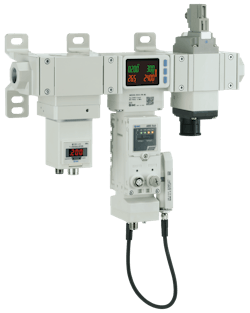

Another example of recent evolution is the ability to integrate industrial networking into control products such as valve manifolds, electro-pneumatic regulators, pressure and flow sensors, etc. In the age of Industrial Internet of Things (IIoT), system operators demand easy-to-maintain systems that allow remote control of components and analytics to track performance and prevent downtime. SMC’s new Air Management System, the AMS Series, satisfies these demands and more.
P&M: What are some of the key features or performance attributes your company is working to include with its pneumatic components and systems, or for which customers are asking?
RB: SMC’s Air Management System, the AMS Series, is a game changer for customers that are concerned with energy savings, predictive maintenance, and ease of installation. Instead of simply controlling the air pressure at a machine’s inlet, the AMS Series sends data via OPC-UA that can be used to monitor the overall health of the machine and has features to automatically adjust air pressure during downtime to improve energy savings.
The AMS Series has other built-in features like wireless connectivity, EtherNet IP, and IO-Link to make installations flexible.
