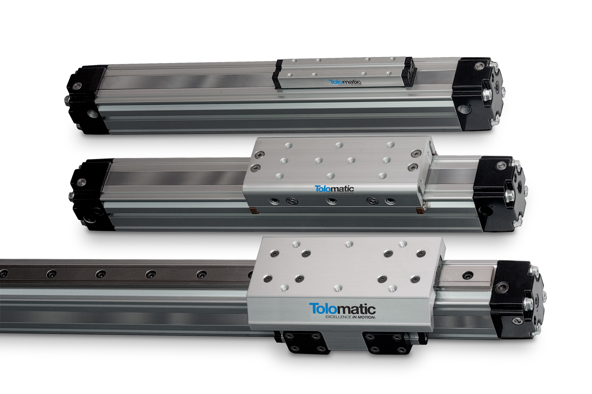

Rodless pneumatic cylinders are a great alternative to conventional rod-style air cylinders and electromechanical actuators because they both support and guide a load. This eliminates the need for other load-bearing elements and reduces costs, size, and design time. The design of rodless cylinders benefits longer stroke, space-constrained applications.
But sizing a rodless cylinder involves more than merely calculating force and stroke. The following tips can help engineers spec the best actuator for a given application.
