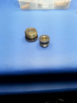

Since the first hydraulic systems, engineers were challenged to permanently close off (seal) ends of cross-drilled holes that create flow patterns for actuation. In some cases, they had few options due to the pressures being 3,000 to 5,000-plus psi. Threaded plugs, welding and ball bearings were commonly used, sometimes in combination, to avoid leaks. But these efforts often created more issues than they solved, such as larger manifolds, additional processes, added costs and extra weight.

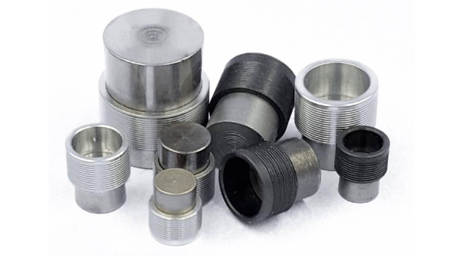

Ball-style plugs are ball bearings inside of machined can or sleeve plug bodies that started out as a high-pressure, leak-proof, permanent seals. Customers wanted a permanent, easy-to-machine-and-install alternative to costly, often-cross-threaded, SAE-style threaded plugs. The ball plug simplified both machining the hole created to seal the end of the communication path (simple counterbore diam. +0.12 /−0.00), and simplified installation. Users only needed to press the ball a specified distance to assure a leak-proof, permanent seal for pressures up to 6,250 psi (at a 3 to 1 safety factor) or 350 bar.
The ball plugs use a simplified counterbore hole. This lets engineers use smaller holes and, therefore, smaller plugs. The results are reduced size of the applications, decreased weight (mass) and material (cost), and no cross-threading or need for rework.
They are well-suited for low and high-volume installation and adaptable to fully automated installation. Installation for low-volume applications was done with a set tool and hammer or arbor press, tapping or pressing the ball into the sleeve until reaching its final desired position. For higher-volume installation, operators use air hammers to drive the ball into the sleeve. This sped up installation but has some disadvantages. Air hammers are loud, and if an operator slips off the ball with the air hammer, it could damage the manifold’s surface, increasing the scrap rate.
