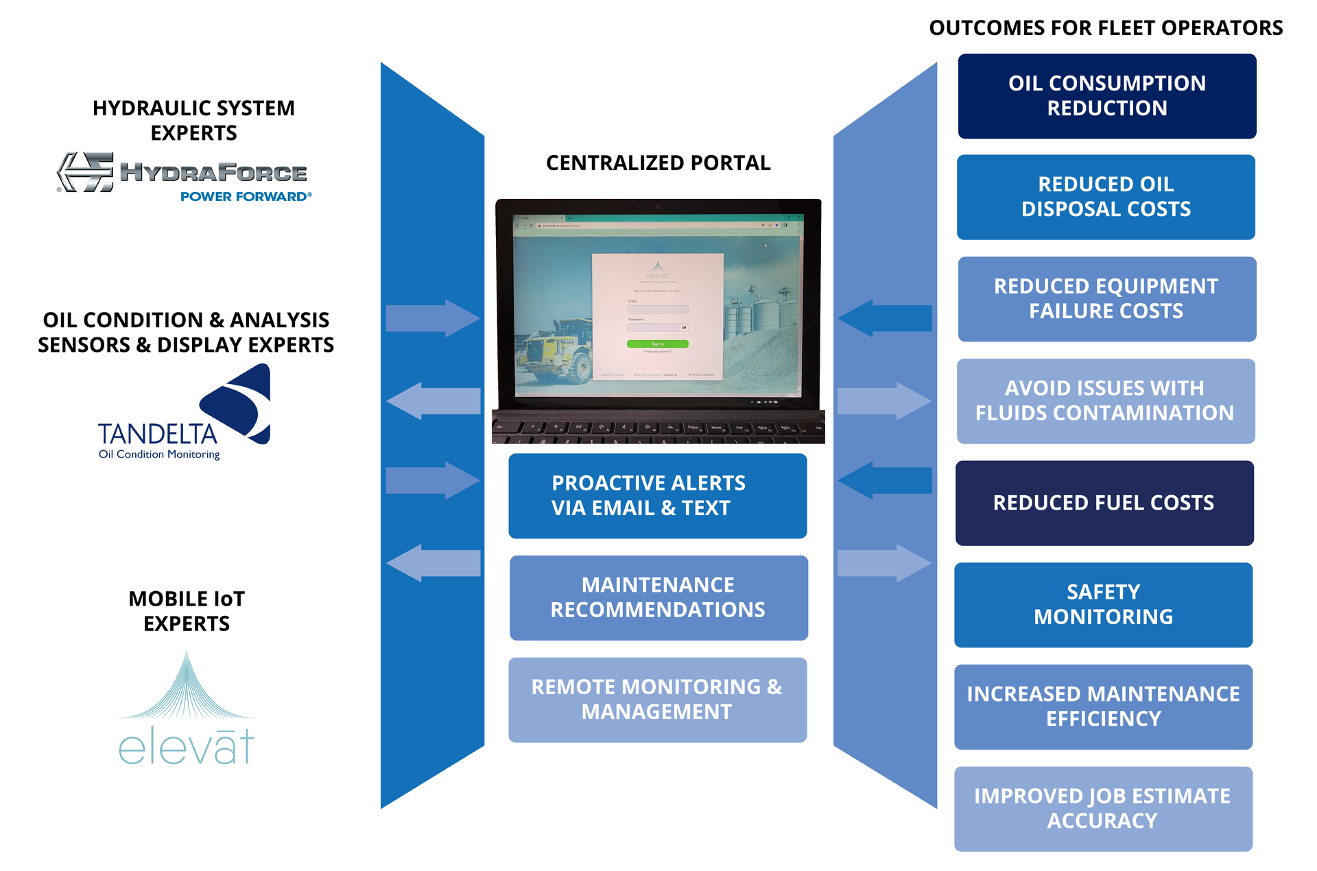

Key capabilities the companies’ integrated solutions will provide include:
- connected machine intelligence and telematics
- remote diagnostics and service tools
- operational alerts and proactive analysis
- over-the-air (OTA) updates
- secure, OEM-branded digital experiences for dealers and end customers.
